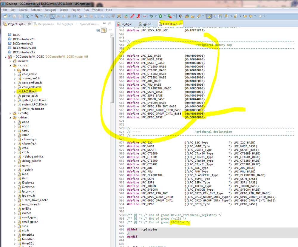

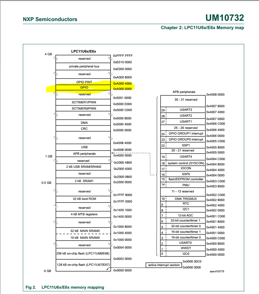

In reviewing the LPC11Exx.h file provided in the CMSIS by the wizard, the address of the GPIOs is same as the LPC1114 and not the location and organization shown in the datasheet for the LPC11E6X series. It shows a location of 5000 0000, where the databook says it's A000 0000. I am really lost as to the libraries and their possible use.
What's the point in the chip file being provided if the accompanying GPIO.h and GPIO.c files are not updated?
Also,  why is the chip file wrong?

LPC11Exx.h file provided in the CMSIS by the wizard, the address of the GPIOs is same as the LPC1114 and not the location and organization shown in the datasheet for the LPC11E6X series. It shows a location of 5000 0000, where the databook says it's A000 0000. "
Please send a set of screenshot of above word. or a video is ok as well.
I will try to reproduce your issue and check it on my side.

accelmotion
7,325 Views
ZhangJennie
David,
Thanks. but from your screenshot I can't know where is the code from. Did you get this code from nxp website? Please let me know where did you download it, thus I can check it directly.
Jun Zhang
7,325 Views
accelmotion
Are you kidding?
These are the files that the wizard generates when you choose CMSIS and not LPCOpen. The LPC11E6X selection gets this LPC11EXX file that does NOT match the actual product. Why?
7,325 Views
ZhangJennie
Thanks for your clarification.
I have reproduced this issue and reported it to development. Please manually revise it for your case.
I will let you know if any update.
Best Regards
Jun Zhang
