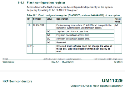

My customers are using LPC845 and they frequently encounter a HardFault while debugging.
Their painstaking analysis revealed that it was related to the FLASHTIM register.
They are using a 30MHz system clock, in which case setting FLASHTIM=1 will prevent the HardFault.
I found similar posts in the community, but the Flash access time specifications are not clear here.
https://community.nxp.com/t5/LPC-Microcontrollers/LPC8xx-Flash-access-time-aka-setting-FLASHTIM/m-p/...

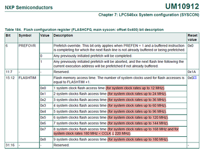

In other LPC series it is clearly stated in UM.
Ex LPC111x :
Ex LPC546xx :
However, this point is not clearly stated in the LPC84x UM.
Please clarify the specifications related to FLASHTIM so that customers can freely handle the system clock.

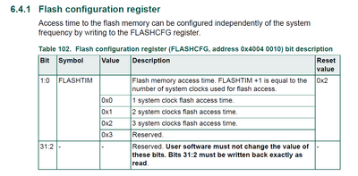

Thanks for the reply, as far as I know I can't find that information anywhere in the NXP documentation.
In other words, So does that mean the flash access time needs to be 24MHz or less as a chip specification?
George
1,321 Views
xiangjun_rong
Unfortunately, the section  6.4.1 Flash configuration register in UM11029.pdf has not any update till now.
But the SDK package adds a function to set up the FLASHTIM bits in FLASHCFG reg.
The core frequency of LPC84x can reach up to 30MHz, if the core frequency is less than 24Mhz, you set the FLASHTIM bits as 0, which means 1 clock cycle delay. if the core frequency is equal or greater than 24Mhz and less than 30Mhz, you set the FLASHTIM bits as 1, which means 2 clock cycle delay.
