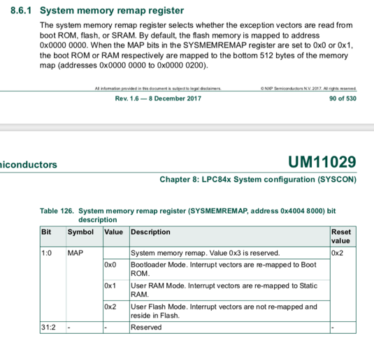

It sounds to me like your debug tools are not correctly triggering a reset after programming flash - which will ensure that the boot rom is correctly run and configures the MCU fully before branching to your application in flash. If you can provide details of the tools that you are using, someone with appropriate knowledge may be able to help further with your setup.
But I can tell you that on many other LPC devices, the first register in address map of SYSCON is SYSMEMREMAP. Here is the info from the LPC845 user manual on it ....

Any chance I can get similar documentation for the register at 0x4000 0000 on the LPC546xx?

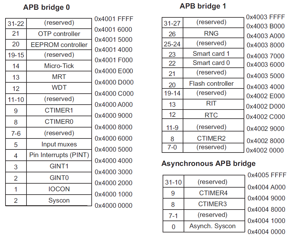

jeremyzhou
Hi Jaroslaw Gorski ,
for the opportunity to serve you.
Firstly, the 0x4000_0000 area is not assigned to the memory likes the Flash or RAM, this area point to APB peripherals, like the Fig1 illustrates.
Fig 1
