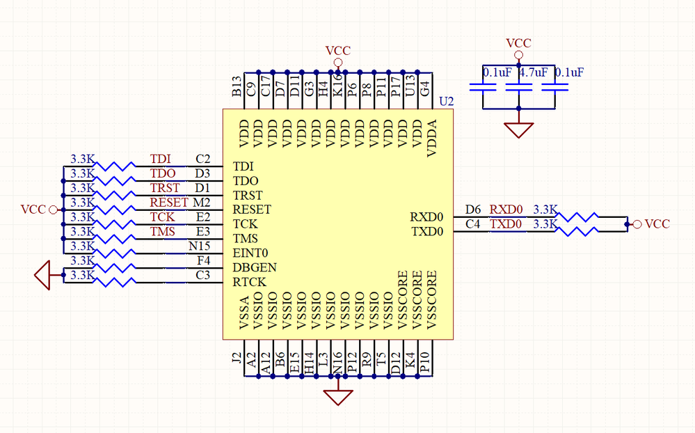

    Below is the circuit diagram of my work, just want to know minimum pin require, so I only connect necessary pins.

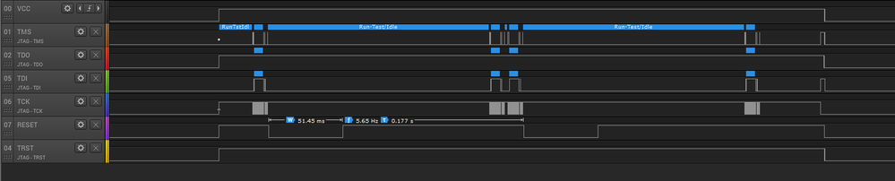

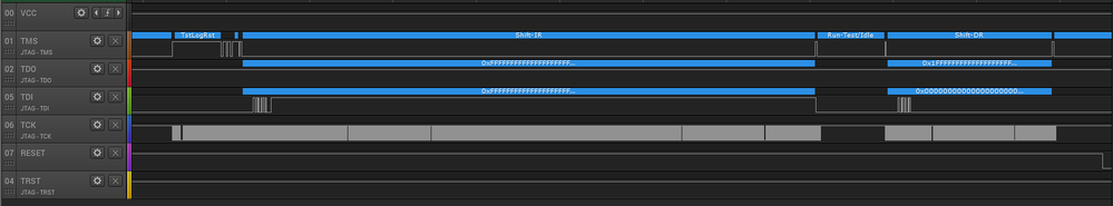

    So I decide to connect LPC2468 to JLINK, program it through Jtag protocol(J-Flash 6.44V), But TDO pin didn't return any response.

    TDO always keep on high.
    Could you please provide application circuit for references?

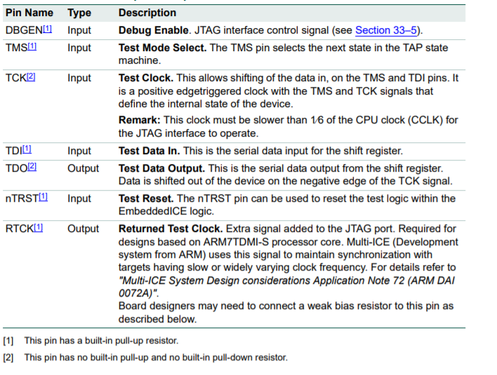

Below is the pins you need to connect:
The JTAG port may be used either for debug or for boundary scan. The state of the DBGEN pin determines which function is available. When DBGEN = 0, the JTAG port may be used for boundary scan. When DBGEN = 1, the JTAG port may be used for debug.
