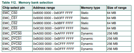

What is the maximum capacity of memory card that LPC1788 will support?

Hi Liam,
This LPC has 256 Megabytes of static memory support and 1GB of Dynamic Memory. You can check this in the following table.
