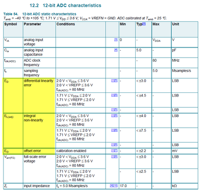

What is the ADC absolute error of LPC54608J512? like LPC185x

By checking, For this part, Please use Eadj as absolute error , after gain and offset calibration(which is done in SDK ADC init function)

LPC546xx doesn't define ADC absolute error. Only Ed, El and Eo are tested.

 The absolute error should be the sum of the offset, gain, and integral non-linearity errors.
We need it to calculate the error rate of the ADC itself.

Our system provide a reference voltage to the external thermistor and then coonect to MCU ADC0INx.
