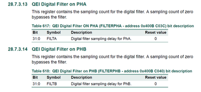

But the QEI module itself is a slightly different, for the LPC1769, there is only one QEI Digital Filter register (FILTER - address 0x400B C03C), which applies for the PHA/PHB/INdex signals.
But for the LPC408x/LPC407x, there are three digital filter register as the following fig, which is described in UM10562.pdf, which can be downloaded from the link:
https://www.nxp.com.cn/docs/en/user-guide/UM10562.pdf
So if you use the QEI driver, you have to modify it to adapts to the LPC1769.

It does help me, @xiangjun_rong . Indeed, that was my question. The most logical thing was to think that it was a general library, but I was surprised that it was not adapted to the differences in the family. I mean, the structure of the RIT timer is as follows, for example:
 * @brief Repetitive Interrupt Timer register block structure
typedef struct {				/*!< RITIMER Structure      */
	__IO uint32_t  COMPVAL;		/*!< Compare register       */
	__IO uint32_t  MASK;		/*!< Mask register. This register holds the 32-bit mask value. A 1 written to any bit will force a compare on the corresponding bit of the counter and compare register. */
	__IO uint32_t  CTRL;		/*!< Control register.      */
	__IO uint32_t  COUNTER;		/*!< 32-bit counter         */
#if defined(CHIP_LPC1347)
	__IO uint32_t  COMPVAL_H;	/*!< Compare upper register */
	__IO uint32_t  MASK_H;		/*!< Mask upper register    */
	__I  uint32_t  RESERVED0[1];
	__IO uint32_t  COUNTER_H;	/*!< Counter upper register */
#endif
} LPC_RITIMER_T;
My experience with the libraries that I have used so far has been that, that the differences between micros or families are "protected" with commands for the preprocessor. That was what confused me in this case, the absence of conditionals in the definition of the structure.
Once this is verified, absolutely nothing needs to be modified. The addresses of all registers are correct. Just ignore the registers that the LPC1769 lacks: FILTERPHB, FILTERINX, FILTERINX, INXCMP1 and INXCMP2.
The only "problem" would be that the general filter for all three inputs is called FILTERPHA. "Problem", if it is, easily solved, changing the name in the structure or with a new #define.
Once it is clear that it is the same filter for the three inputs, the name it has is not a problem for me. So problem solved.
