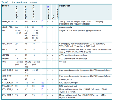

Hi All,
I was going through the datasheet of LPC55S28JBD100 , There is no dedicated Vbat pin . Instead there is VBAT_DCDC and VBAT_PMU. As per pin description, VBAT_DCDC pin is output of DC DC convertor block and VBAT_PMU is analog supply. To which pin i need to connect the the battery to MCU for battery operation when main supply VDD is absent.

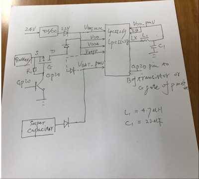

Currently we are looking for the possible approach for Switching between Main supply (LDO) and Vbat Operation.
We have Two backup supplies requirement , Battery and supercap. Either one of the backup supplies is selected but provision should be provided for both (either one of the backup circuit component will be mounted) and other is made DNI(Do not populate)
Super cap back supply is only for RTC and monitor and logging the tampering Events connected to Vbat pin (if Super cap is selected as backup supply by enduser)
we have also have one ADC monitoring 24V from which the 3.3V is derived.
Also there is energy hold up circuit for 3.3V upto 500ms (upto which LDO supplies power to MCU) to shutdown the MCU as soon the Main power outage .
Battery backup is for RTC , Event logging and also the Peripherals and Core of the MCU and it act as a alternate option for short duration when Main Supply (LDO Voltage) is not present
If Battery backup is selected by enduser, then Vbat pin will not be connected to vbat .Does VDD pins Power to Backup circuitry such as RTC? and Tamper GPIOS?

I prefer to the approach1 scheme.
The above is the LPC552x power pins, the VBAT_DCDC pin provides power for the core and most of peripheral, in other words, the pin provides most of the power for the chip. The VBAT_PMU provides power for the RTC, crystal, PLL..., so if you want to power the RTC while the chip is powered down, you have to connect the super cap to the pin VBAT_PMU. The VDD provides power for the I/O cell, the VDDA provides power for the analog part.
The VBAT_DCDC pin is an input pin for the internal DC/DC converter, the internal DC/DC converter can output 1.1V power for the VDD_PMU via external inductor L1 and capacitor C1.
So I draw a fig manually based on your requirement, pls refer to it. I suppose that you can connect a GPIO pin to the G gate of P MOSFET directly or via a transistor, it is dependent on the G pin driving capability of the P MOSFET.
Because you connect 24V power supply, I think the DC/DC converter is required to get 3.3V for the LPC5528.

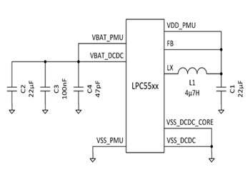

On hardware design, we need to connect VBAT_DCDC and VBAT_PMU pin, refer below EVK schematic:
https://www.nxp.com/webapp/Download?colCode=LPC55S69-SCH
We recommend to connect battery directly to VBAT_DCDC and VBAT_PMU. DC-DC needs a 4µ7H inductor and a 22µF ceramic capacitor. See below

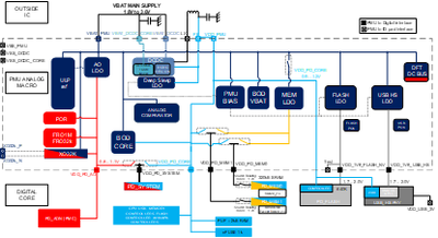

Regarding to RTC power supply of LPC55S6x,pls refer to section 13.2.2 Power domains in UM11126.pdf. The RTC is powered by the PD_AO: Power Domain Always On.
This is LPC55 power supplies
This domain always has power as long as sufficient voltage is available on VBAT ([1.8 V –3.6 V]). You can run the RTC with an external crystal in deep power-down mode.
I2C is under PD_CORE power domains. So it's not possible use VBAT for it.

I attach the power domain design for LPC55xx family, it adapts to LPC5528.
Hope it can help you
