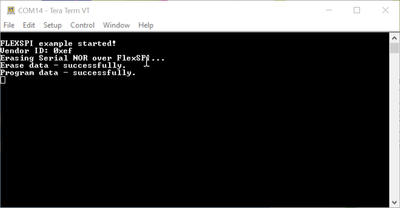

I am trying to use the internal flash of the RT1064 based on this example (https://community.nxp.com/t5/i-MX-RT-Knowledge-Base/How-to-use-the-RT1064-on-chip-flash-as-NVM/ta-p/...) and I am getting this error.
Hard Fault (HFSR)
FORCED (30) Indicates a forced hard fault, generated by escalation of a fault with configurable priority that cannot be handled, either because of priority or because it is disabled.
Usage Fault(UFSR)
UNDEFINSTR (0) Undefined instruction.

Hi @jalvarez96,
I followed the steps mentioned in the article and seems to be working on my side.
Could you please double check? Or please share with me the exact changes you made in your project.
Daniel.
