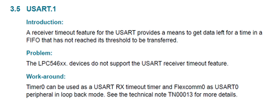

1) Receive timeout information is not there in datasheet as well as example code. How do i implement this receive timeout in FIFO mode. Example, if Rx FIFO size is 8 and i have received only 1 byte then that byte will remain in the FIFO since FIFO level of 8 characters hasn't been crossed so no interrupt will be raised. In such cases, receive timeout interrupt is provided by Microcontroller
What protocol you are talking about ?
There are very few UART-based protocols (like Modbus RTU) which really use timeouts, so almost no UART peripheral unit has hardware support for such a feature. You can always use timers and software.

Maybe the OP is talking about the Errata for the device?:
