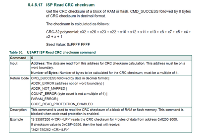

No, I didn't add the checksum to my image. Following UM10912, the "S" command doesn't read a checksum; it calculates this.
Maybe the problem only appears in the In-System Programming (ISP) interface. I use the USART ISP interface described in Section 5.4 of UM10912. Can you replay it?

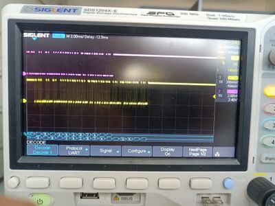

Hello, I test it on my side and seems to be work it well.
I use real term; do you have the channel of UART available to use the PC instead of the STM32?
Pavel
2,868 Views
zokart
Hello Pavel,
Your picture shows expected behavior. I have the same except for S output.
I'll try to create a channel with PC and figure out where the source of disturbance is in my configuration. I'll come back with the results if I get it.
