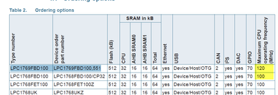

Hello @LPC-confuso
Yes, LPC1769/lpc1768 have ROM USB driver. LPC1768 also can use it.
The difference between the two chips is the MAX cpu frequency :
