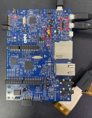

For USB0 (USB FS), board jumper settings are as below
J9 2-3 full speed mode; J10  shunt full speed; J11 2-3, J12 2-3, J13 2-3 , need provide external power through J1.

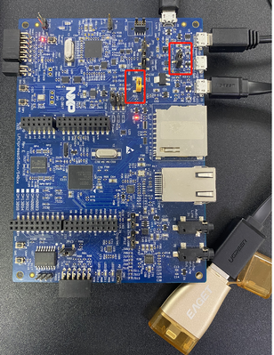

For USB1 (USB HS), board jumper settings are as below
J9 1-2 high speed mode; J10 open high speed; J11 2-3, J12 2-3, J13 2-3 , need provide external power through J1.
As the default code is for FS USB. To work with HS USB, revise source\usb_host_config.h macro as below :
#define USB_HOST_CONFIG_OHCI (0U)
#define USB_HOST_CONFIG_IP3516HS (1U)

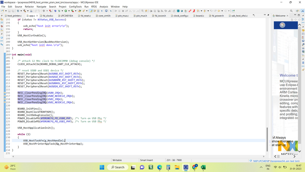

Arularasan
@ZhangJennie
in debug mode
it prints only " host init done "
when I plug in u disk in USB1 nothing is printed in terminal.
please reply @ZhangJennie

Arularasan
@ZhangJennie thanks for your support.
After modify demo code  macro definition in usb_host_config.h and jumpers to USB1 its working
thank you...
