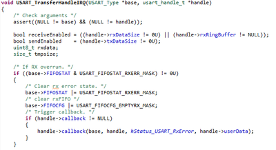

DineshRibadiya
hello Frank,
Thanks for the prompt response!
I am handling the USART_FIFOSTAT_RXERR_MASK. please refer below image and suggest me if i am missing anything else.

frank_m
Senior Contributor III
I would use the debugger, and check if any UART or FIFO  error flag is set in peripheral registers when reception stops.
To be honest, it is years since I worked on UART code for NXP MCUs the last time. I did a lot with other devices, many without FIFO (some rely on DMA instead).
UART is not really "CMSIS", i.e. there is hardly anything common amongst vendors, the concepts and register interface is highly specific. Perhaps you need the USART section of the MCU's  user manual for reference.

DineshRibadiya
@frank_m I go through the other post and found the that, it is same issue which is i am facing.
I have made changes as per below image. I see some improvement but getting still same issue. I would appreciate your suggession.

            if (!sendEnabled)
                base->FIFOINTENCLR = USART_FIFOINTENCLR_TXLVL_MASK;
                base->INTENSET = USART_INTENSET_TXIDLEEN_MASK;
    /* Tx idle and the interrupt is enabled. */
    if ((0U != (base->INTENSET & USART_INTENSET_TXIDLEEN_MASK)) && (0U != (base->INTSTAT & USART_INTSTAT_TXIDLE_MASK)))
        /* Set txState to idle only when all data has been sent out to bus. */
        handle->txState = (uint8_t)kUSART_TxIdle;
        /* Disable tx idle interrupt */
        base->INTENCLR = USART_INTENCLR_TXIDLECLR_MASK;
        /* Trigger callback. */
        if (handle->callback != NULL)
            handle->callback(base, handle, kStatus_USART_TxIdle, handle->userData);
    /* ring buffer is not used */
    if (NULL == handle->rxRingBuffer)
        tmpsize = handle->rxDataSize;
        /* restore if rx transfer ends and rxLevel is different from default value */
        if ((tmpsize == 0U) && (USART_FIFOTRIG_RXLVL_GET(base) != handle->rxWatermark))
            base->FIFOTRIG =
                (base->FIFOTRIG & (~USART_FIFOTRIG_RXLVL_MASK)) | USART_FIFOTRIG_RXLVL(handle->rxWatermark);
        /* decrease level if rx transfer is bellow */
        if ((tmpsize != 0U) && (tmpsize < (USART_FIFOTRIG_RXLVL_GET(base) + 1U)))
            base->FIFOTRIG = (base->FIFOTRIG & (~USART_FIFOTRIG_RXLVL_MASK)) | (USART_FIFOTRIG_RXLVL(tmpsize - 1U));
Hope it can help you
XiangJun Rong
