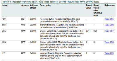

I'm porting code from an LPC1768 to an LPC1817 and have a problem that the UART is running at the wrong speed. All the old code looks sane and from what I can read in the documentation the registers in the 18xx should be pretty much directly compatible with the 17xx.
So to figure out what's going on I wrote some raw C testcode that access the registers directly just to verify that the MCU and I are on the same page, but apparently we're not. This is the raw testcode:
    *((volatile uint32_t *) 0x40086100) = 0xf1; // Set up P2_0
    *((volatile uint32_t *) 0x40086104) = 0xf1; // Set up P2_1
    *((volatile uint32_t *) 0x40051508) = 0x07; // Enable UART0 clock (should already be enabled)
    *((volatile uint32_t *) 0x4008100C) = 0x83; // Set DLAB in LCR
    *((volatile uint32_t *) 0x40081000) = 6; // Set low byte divider
    *((volatile uint32_t *) 0x40081004) = 7; // Set high byte divider
    *((volatile uint32_t *) 0x40081028) = 0x10; // Set fraction divider
    volatile uint32_t uart0_lcr = *((volatile uint32_t *) 0x4008100C);
    volatile uint32_t uart0_dll = *((volatile uint32_t *) 0x40081000);
    volatile uint32_t uart0_dlm = *((volatile uint32_t *) 0x40081004);
    volatile uint32_t ccu1_pm = *((volatile uint32_t *) 0x40051000);
    volatile uint32_t ccu1_base_stat = *((volatile uint32_t *) 0x40051004);
    volatile uint32_t ccu1_usart0_cfg = *((volatile uint32_t *) 0x40051508);
    volatile uint32_t ccu1_usart0_stat = *((volatile uint32_t *) 0x4005150c);
    volatile uint32_t ccu2_pm = *((volatile uint32_t *) 0x40052000);
    volatile uint32_t ccu2_base_stat = *((volatile uint32_t *) 0x40052004);
    volatile uint32_t ccu2_usart0_cfg = *((volatile uint32_t *) 0x40052500);
    volatile uint32_t ccu2_usart0_stat = *((volatile uint32_t *) 0x40052504);
Aaaand it doesn't work. When I check the values they all look sane, except for dll and dlm that still have their reset values of 1 versus 0. Clearly I'm missing something that probably is very obvious when you see it, but I've been trying to figure out what for a few days and I'm pretty much stuck. And the UART still run at the wrong speed and changing the dividers make no difference (verified with oscilloscope).
So if anyone could throw a quick look at this and tell me what I'm missing I'd be very grateful.
/M

Solved it!
Writing down the explanation just in case someone else googles for the same problem and ends up here.
The problem was that the boot mode for the board (early prototype, there's some fun quirks here and there that we're ironing out) was wrong so it went into the built in boot loader in the MCU. Since we're so early in the bring up I still run the board entirely on JTAG so it's not something that I even noticed, but when I looked closer at the registers I noted that the fraction divider was set to 0x85 even though the reset value according to the documentation should be 0x10. However 0x85 is what's expected after "Reset value after UART0/3 boot"!
So I patched the board with a little wire that stops the MCU from going into boot loader mode and now it works! Or rather, right now it runs at 111.111 BAUD rather than 115.200 since 12 MHz can't be cleanly divided by an integer, but it's close enough for me to be very, very happy since I've been chasing this problem for days.
