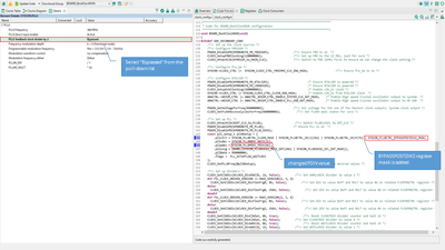

We generate the clock setting code with MCUXpresso Config Tools. Then, as shown in the figure below, setting "PLL0 feedback clock divider by 2" to "Active" solves the problem, and setting it to "Bypassed" causes the problem. We presume that the problem was solved using the Spread Spectrum Function because "PLL0 feedback clock divider by 2" was changed to "Active".
(attached file:clock_config_active(OK).c、clock_config_bypassed(NG).c)
1. Does this difference in settings have anything to do with this problem?
2. Is it possible that the settings are outside the recommended range of MCU even when using MCUXpresso Config Tools?
3. Does "feedback divider" indicate MDIV? The generated source code appears to be related to PDIV.
Thank you for your cooperation.

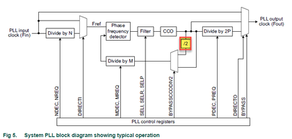

1. It could be the problem, this feedback clock divides is helpful to generate high frequencies in the PLL, if it is bypassed it is possible that the frequency is not locked correctly. The decision of using this divider is based on the frequency of the input clock.
2. This could be the case, I suggest you check the PLL value with the CLKOUT signal in the MCU.
3. This is more related to the Divide by M, in this figure you can see the block where this feedback divider is located.
If you have more questions do not hesitate to ask me.
Omar

1. If the input clock frequency is too low; the feedback divider might help the PLL to reach the desired frequencies if the divide by M value is not enough.
2. The CLKOUT signal is to have a way to physically measure the clock signal of the PLL or any other clock. Enabling that output should not have an impact on the PLL functioning.
