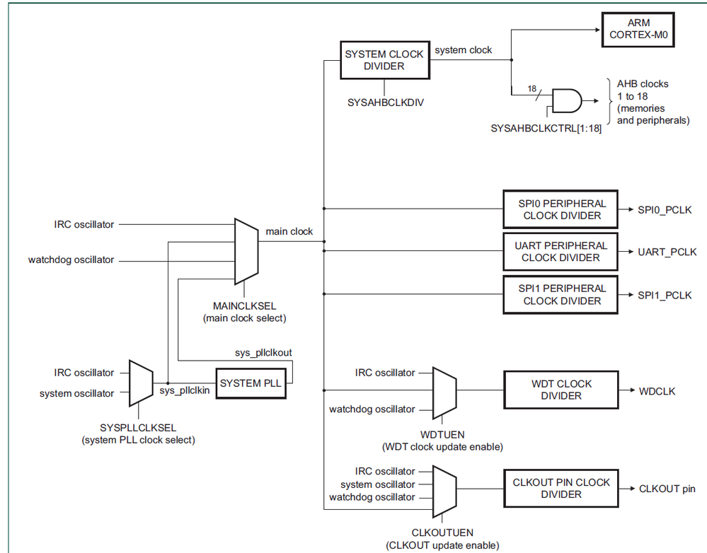

I want to use the internal oscillator,but the  internal oscillator of the LPC1114 does not start。The phenomenon appears as when we use the extern oscillator,the timer can work well ,but when we use the  internal oscillator,the same timer can not work.the configurations of the internal oscillator are as follows:

   Please use the CLKOUT pin to test the IRC oscillator and system oscillator at first.
   This is the clock block diagram:
If you want to use the IRC oscillator, and use the PLL, in the MAINCLKSEL, you need to select sys_pllclkout, in SYSPLLCLKSEL, you need to select IRC oscillator, not the system oscillator.  After the configuration, I suggest you use the CLKOUT pin to test the main clock at first, just make sure your timer have the clock.
Wish it helps you!
If you still have question, please kindly let me know!
Kerry

i have solved the problem,thanks
