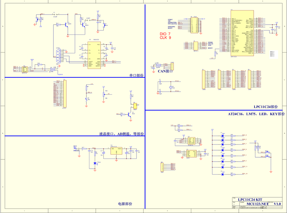

I used a few examples of NXP downloaded to the LPC11C24. To debug. I found IO port PIO2-11, the corresponding light is always on. But the code does not initialize it and does not light it. Why is that?IMG_0920.JPG
I blocked the entire main function,the LED is still on.Who knows to give me a reminder?

Since you already remove all the available code, that handle the PIN,  I strongly suggest that you check the schematics of the board, to review where is attach the GPIO and the LED,  Since there is no chance that the LED it is always on, by the software.
By the way, this board it is not an official NXP board, so if you can share the schematics, we can take a look. But it is out of our scope, since there is no way to test from our side. I apologize for this inconvenience.

I am very happy to share the schematic,Software can not control GPIO, I have no way to solve this problem.
There are some Chinese on the map.
The code from NXP official example of this "lpcopen_v2_00a_keil_iar_nxp_lpcxpresso_11c24",but I use the following example to be controllable.
