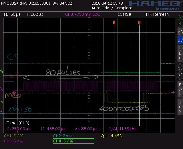

I am trying to communicate with an SD card using an LPC5411 dev board based on developing my own SD card custom driver. I m basing the development on the following tutorial Porting FatFs file system to KL26 SPI SD card code  . I have the SD card connected externally to the development board. I m having a problem initialising the SD card. I have made sure of the following. I send 80 pulses of a clock signal with Chip Select high and MOSI high. After this i m setting the CS low and sending the byte values 0x40, 0x00, 0x00, 0x00, 0x00, 0x95 for CMD0. I m not receiving any byte values back on the MISO line. I was checking the scope and it appears that the CS, MOSI and CLK are working but the MISO isnt. Is there a timing issue. I have attached the screen grab of the the SPI lines.
The code I m using the generate these pulses is as follows

uint8_t MMCInit(){ spi_master_config_t userConfig = {0}; spi_master_config_t masterConfig = {0}; uint8_t i = 0,k = 0,tmp = 0; uint16_t cnt=0; uint8_t buff[512]; SPI_MasterGetDefaultConfig(&userConfig); srcFreq = EXAMPLE_SPI_MASTER_CLK_FREQ_LOW;//EXAMPLE_SPI_MASTER_CLK_FREQ; masterConfig.sselNum = (spi_ssel_t)EXAMPLE_SPI_SSEL; SPI_MasterInit(EXAMPLE_SPI_MASTER, &userConfig, srcFreq); spi_transfer_t xfer = {0}; status_t xferStatus = kStatus_Success; uint8_t ucTemp; for (i = 0U; i < BUFFER_SIZE; i++) { srcBuff[i] = 0xFF; } xfer.txData = srcBuff; xfer.rxData = destBuff; xfer.dataSize = sizeof(destBuff); // SPI_CS_Low(); xferStatus = SPI_MasterTransferBlocking(EXAMPLE_SPI_MASTER, &xfer); //40 00 00 00 00 95 for CMD0 //48 00 00 01 AA 0F for CMD8 //7A 00 00 00 00 75 startCMD[0] = 0x40; startCMD[1] = 0x00; startCMD[2] = 0x00; startCMD[3] = 0x00; startCMD[4] = 0x00; startCMD[5] = 0x95; // xfer.configFlags = kSPI_FrameAssert; xfer.txData = startCMD; xfer.rxData = endBuff; xfer.dataSize = 7;//sizeof(endBuff); 6 bytes and one more SPI_CS_Low(); xferStatus = SPI_MasterTransferBlocking(EXAMPLE_SPI_MASTER, &xfer); SPI_CS_High(); }

puddletowntom
Hi Kerry,
Last Friday I made some progress. I started to see something on the MISO line. For the reset command, eg  MMCWriteCmd(CMD0,0x00,0x95);   it seemed like I was receiving the expected value back. eg the 1 value (00000001). However, I think I was receiving a decimal value of 9 for the CMD8 command. eg MMCWriteCmd( CMD8,0x1AA,0x87 ); I dont really know why this is. I have attached a screen grab to show that there is in fact something on the MISO line. However I m not sure if my clock sequence is correct. If I send a byte using the SPI_MasterTransferBlocking() command for each individual byte then I wont have a continuous clock. For the 72 clock pulses does the clock need to be continuous or can it be broken up?
Chip Select(Green) ==> (GPIO pin) port0_pin10
Clock(Purple) ==> port0_pin19
MOSI(Yellow) ==> port0_pin20
MISO(Blue) ==> port0_pin18,
I m not certain that the way I m using the Send_Byte() function is correct. The code I last worked on is attached below.

A few thoughts having written a SD card interface in assembler on an LPC1517:
I can't exactly tell from the oscilloscope trace how fast the 80 pulses are, but they should be no quicker than 400kHz. I think you might be a bit close to the limit.
The pulses don't have to be evenly spaced. I send five 16-bit words of 0xFFFF via the SPI interface, and I use 200kHz until it responds to CMD0 then speed it up.
A reply of 9 from the card = CRC check fault.
I'm just wondering if MMCWriteCmd( CMD8,0x1AA,0x87 ) is correct. Does your MMCWriteCmd function write 8-bit values? If so, you've got a 9-bit value in there, which is probably getting truncated to 8 bits.
You've also got //48 00 00 01 AA 0F for CMD8, when the CRC should be 0x87.
I send CMD 8 as 0x4800, 0x0001, 0xAA87
It should respond with 0x01, followed by two 16-bit words which echo the command.
Another thing, the spec says you should send 8 extra clock pulses at the end of each command for it to finish its internal workings.
