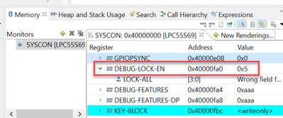

I would like to disable the debug- as well as the programming- (SWD) interfaces on our custom LPC55S69 board  in order to secure our IP.
While reading the DEBUG_FEATURES and DEBUG_FEATURES_DP returns as expected, reading DEBUG_LOCK_EN resulted in 0x5, which means all write accesses to the debug and programming registers are permitted and ignored.
I was wondering, where the write lock is set to 0x5 in the examples. I couldn't find the line.
Hope you can help me with this.
Thanks for your help and all the best,
marvin

Hi Marvin,
So you would like to set 0xA to the register? This means that you enable write access to security registers.
I also read value when starting a new project and I also read 0x5 value. I am going to contact internal team to see if they have some feedback about this.

Hi Marvin,
I have received confirmation from internal team. Please check it below.
After POR, the related six registers (CPU0_DEBUG_FEATURES,CPU1_DEBUG_FEATURES…) will be configured based on the PFR data in the CFPA DCFG_CC_SOCU_NS_PIN and  DCFG_CC_SOCU_NS_DFLT (0x9de20 – 0x9de27), and CMPA DCFG_CC_SOCU_PIN and DCFG_CC_SOCU_DFLT (0x9e410 – 0x9e41b), and then the ROM will set DEBUG_LOCK_EN to 0x5.
You can refer to AN13037(LPC55Sxx Debug Authentication) for details.
