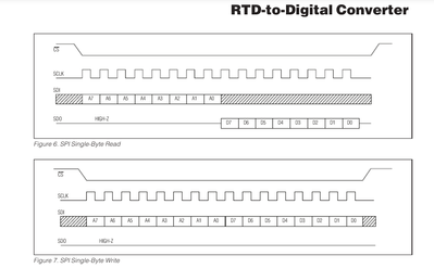

I wrote the following IRQ Handler to transfer one byte of SPI data to a slave. The handler is called by the function writeRegister8() which first writes the address of the slave followed by the slave data that is to be written to that address. The same handler is called by the function readRegister8() which first writes the address of the slave to be read from and then reads the data from that address using the dedicated function SPI_ReadData(). The function writeRegister8 works, but the readRegister8 function fails when SPI_ReadData() is called. All SPI_ReadData() does is return base->FIFORD, a 32 bit register. Although SPI_ReadData typically returns values like 0xe00ff, 0xe003f or 0x300d0, the scope does not get triggered. Channel 1 of my scope is connected to SCK and channel 2 to MISO (SDO). The scope does correctly capture the Clock and MOSI signals when SPI_WriteData is executed. Can someone tell me why SPI_ReadData is failing? I think the problem is related to something I don’t understand about the nature of the FIFO in the LPC54018, since I am attempting to read or write a single byte to the slave. I know that my slave works and is wired correctly because I have implemented a similar version of my writeRegister8 and readRegister8 function using the masterCallback function as implemented in the SDK example spi_interrupt_b2b_master_transfer. In this implementation my scope correctly captures both MOSI and MISO signals. Note that both implementations are C++. I would like to understand which of the two methods I am experimenting with is preferable for the purpose of transferring byte sized data to a SPI slave. Is one more efficient than the other? Will the interrupt driven method take more or less time than the masterCallback method? uint8_t SPIAddr; static uint32_t RxData; static uint8_t TxData; void FLEXCOMM9_IRQHandler(void) { if ((SPI_GetStatusFlags(SPI9) & kSPI_TxNotFullFlag)) { if (SPI_RW == WRITE) // A second Write is coming { // need to disable Both Rx & Tx interrupts or handler wraps SPI_DisableInterrupts(SPI9, kSPI_TxLvlIrq | kSPI_RxLvlIrq); // SSEL will be deasserted (stays low) at the end of transfer SPI_WriteData(SPI9, (uint16_t)(SPIAddr), 0); } if (SPI_RW == READ) { // need to disable Both Rx & Tx interrupts or handler wraps SPI_DisableInterrupts(SPI9, kSPI_TxLvlIrq | kSPI_RxLvlIrq); // SSEL will be deasserted (stays low) at the end of transfer SPI_WriteData(SPI9, (uint16_t)(SPIAddr), 0); } } if ((SPI_GetStatusFlags(SPI9) & kSPI_RxNotEmptyFlag) && (SPI_RW == READ)) { RxData = SPI_ReadData(SPI9); SDK_DelayAtLeastUs(10, BOARD_BOOTCLOCKFRO12M_CORE_CLOCK); // 10us } if ((SPI_GetStatusFlags(SPI9) & kSPI_TxNotFullFlag) && (SPI_RW == WRITE)) { // End of transfer // Set MOSI high after the write SPI_WriteData(SPI9, (uint16_t)(TxData), kSPI_FrameAssert); } SPI_IRQ_Finished = true; IRQH_count++; SDK_ISR_EXIT_BARRIER; } uint32_t MAX31865::readRegister8(uint8_t RegAddr) { SPI_RW = READ; SPIAddr = RegAddr & 0x7F; // make sure top bit is not set TxData = 0; SPI_EnableInterrupts(SPI9, kSPI_TxLvlIrq | kSPI_RxLvlIrq); while (SPI_IRQ_Finished != true) { } SPI_IRQ_Finished = false; return RxData; // RxData obtained in SPI_Handler } void MAX31865::writeRegister8(uint8_t RegAddr, uint8_t writeData) { SPI_RW = WRITE; SPIAddr = RegAddr | 0x80; // top bit keeps PCSn signals asserted between transfers TxData = writeData; SPI_EnableInterrupts(SPI9, kSPI_TxLvlIrq | kSPI_RxLvlIrq); while (SPI_IRQ_Finished != true) { } SPI_IRQ_Finished = false; }

Hi, Jerry,
It appears that you use MC31865, it is a RTD converter.
This is the SPI timing:
For the above SPI timing, you should set the data length as 16 bits, in other words, after all 16 bits has transferred, the flag in SPI status will be set, then you can read the data.

My SPI IRQHandler performs a byte write to the slave by calling SPI_WriteData() to write the slave address (SPIAddr), and a second call to SPI_WriteData() to write the transmit byte (TxData).  The two 8 bit writes is equivalent to a 16 bit write.
As the timing diagrams you posted illustrates, to read a byte from the slave one must first write the address of the slave, which I implement in my handler using

As you said that  during this call my oscilloscope doesn’t detect any clock or MISO transitions. The value that my readRegister8() function returns is the value that my scope captured on the MISO pin during code line (1).
If you can not see the SCK, MOSI even CS signal of SPI via scope, I suppose that it is another question, have you set up the pin mux.

8,465件の閲覧回数
jmueckl
Rong,
Below is the code that I tested based on your recommendations.  I do like your implementation because it avoids the need for an IRQ handler, but it has the same problem as the code I submitted at first in void FLEXCOMM9_IRQHandler(void). Spi_WR() works but spi_RD() does not.  My oscilloscope shows the correct MOSI and MISO signals for both functions, including the correct read data as the last byte of the MISO signal.
The following illustrates the problem I am seeing:
   ReadTest1 = spi_RD(MAX31865_CONFIG_REG);   // ReadTest1 = 0xff
   spi_WR(MAX31865_CONFIG_REG, 0xaa);              // Write 0xaa to the address just read
   ReadTest1 = spi_RD(MAX31865_CONFIG_REG);   // ReadTest1 = 0xd0 (correct value)
For some reason, spi_RD() returns the correct results only if I insert a spi_WR() after the first call.
It may be helpful to realize that my code works when it is implemented in a masterCallback which looks like the SDK example
static void masterCallback(SPI_Type *base, spi_master_handle_t *handle, status_t status,               void *userData)
                               masterFinished = true;
My masterCallback implementation has the same phase, polarity, sselNum & sselPol configuration settings as does this code, which I prefer.  The only configuration differences are that the masterCallback implementation has dataWidth of 8 bits verses 16 bits.  The variable ConfigFlags is 0x100000 in the Callback.
// from LPC54018.h
// #define SPI9_BASE     (0x4009A000u)
// #define SPI9          ((SPI_Type *)SPI9_BASE)
#define SPI9_FIFOWR_ADDR 0x4009AE20   // Offset 0xE20
#define SPI9_FIFORD_ADDR 0x4009AE30   // Offset 0xE30
#define SPI9_FIFOSTAT_ADDR 0x4009AE04 // Offset 0xE04
void MAX31865::spi_WR(uint8_t RegAddr, uint8_t writeData)
       WRData = 0x0F1E0000 | ((RegAddr | 0x80) << | writeData;
       //while(!(SPI9_FIFOSTAT_ADDR * 0x10)) {}; // While TX is empty (has no effect on result)
       *(uint32_t *)SPI9_FIFOWR_ADDR=WRData;
uint8_t MAX31865::spi_RD(uint8_t RegAddr)
       uint8_t temp_var = 0;
       WRData = 0x0F1E0000 | ((RegAddr & 0x7f) << 8);
       *(uint32_t *)SPI9_FIFOWR_ADDR = WRData;
       //while(!(SPI9_FIFOSTAT_ADDR * 0x10 )) {}; // While TX is empty (has no effect on result)
       temp_var= *(uint32_t *)SPI9_FIFORD_ADDR & 0xFF;
    return temp_var;
8,503件の閲覧回数
xiangjun_rong
Hi, Jerry,
It appears that you misunderstand the SPI mechanism. When the SPI module is configured as a master, after your write the SPI_FIFOWR register, the SPI module will generate the SPI timing, the bits in SPI_FIFOWR will appeared on MOSI with SCK clocking, at the same time, the master will receive data from MISO pin with SCK and save the data in SPI->FIFORD. In other words, reading data from SPI->FIFORD can NOT generate SPI timing.
This is the model of the SPI writing/reading, firstly, write SPI_FIFOWR, after the data in SPI_FIFOWR has been transmitted, a flag will be set, after the flag is set, it means that the data has been received also, it is okay read it to memory variable temp.
SPI_FIFOWR=0x0F1E0000|BYTE_ADDRSSS<<8;
While(!(SPI_FIFOSTAT*0x10)) {}
temp= (SPI_FIFOWR&0xFF);
Hope it can help you
XiangJun Rong
