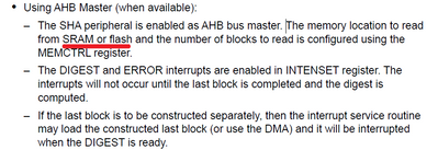

1. Is it possible to use a flash memory area directly as a source in register MEMADDR, according to the LPC manual only SRAM0 or SRAMX can be used, but the version with direct flash access is also suggested here in the forum, or does the flash data have to be copied to the RAM first? .
The calculation with the flash memory actually worked without any problems and also generated correct SHA checksums.

As stated in UM, SHA engine can read from SRAM or flash.

In the UM register description of the memory address register MEMADDR, only the SRAM is specified, thats why i was a little bit confused
