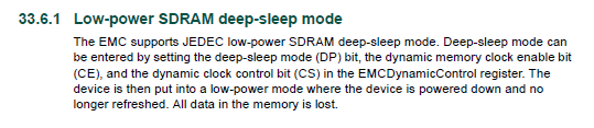

In the user manual (UM10912) it states that the external memory controller (EMC) can put the connected device into low power mode. See remark at the bottom of the attached page. I am able to set the CE and CS bits using the fsl_emc driver included in the SDK, but where is the DP bit and how does one set it?
I have tried the following functions prior to putting the LPC device to sleep, but results in terms of current consumption are not consistent.
   EMC_EnableDynamicMemControl(EMC, true);
   EMC_EnterSelfRefreshCommand(EMC, true);
   EMC_EnterLowPowerMode(EMC, true);
I am using Micron SDRAM. According to their datasheet, power-down requires a CKE high to low transition while all banks are idle. Do I need to ensure that all banks are idle before the above commands? If so, what is the best way to achieve that?

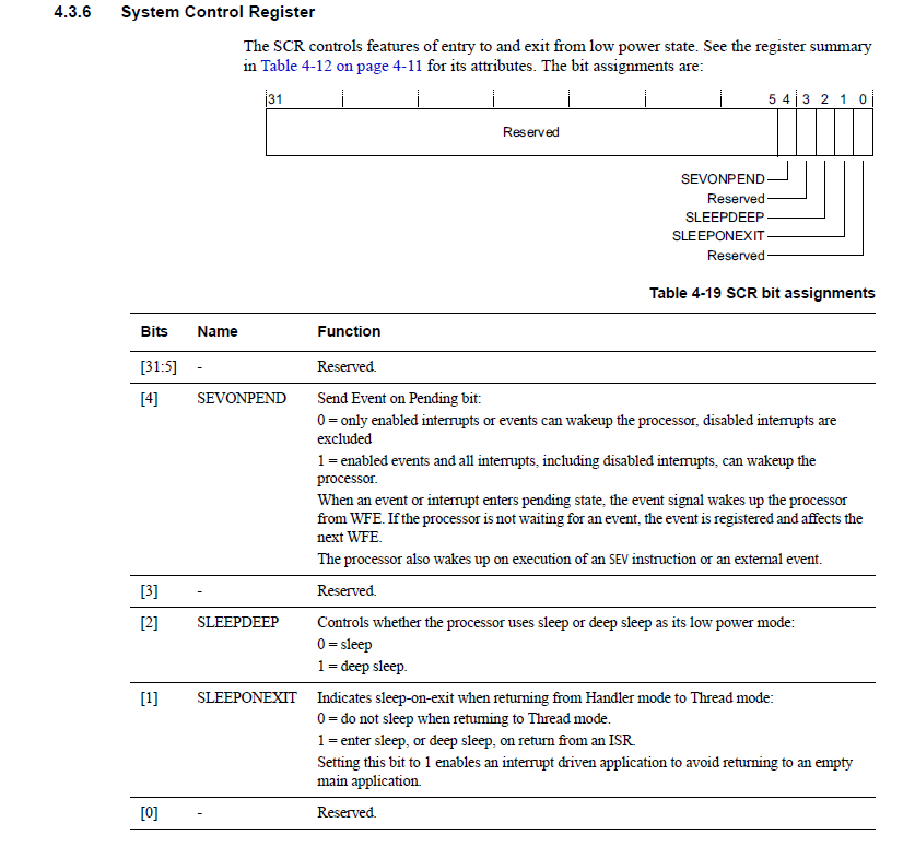

I suppose that the Deep Sleep bit is located at the SCR register, which is part of the Cortex-M4 core registers.
You can use the structure to access the bit:
SCB->SCR|=1<<2;
The SCB is defined in core_cm4.h if you use SDK package.
Hope it can help you

Thank you for the response, but the SCR bit control you are describing is for the main micro controller (Cortex-M) sleep mode. I am specifically trying to use the LPC's external memory controller to place the external SDRAM in sleep or lowest possible power state. I do not need to preserve any data in the external SDRAM in this case.
This statement from the manual implies that the DP bit is in the EMCDynamicControl register:

It is said that bit 13 in EMC Control register is DP bit, but in UM10912, it is "Reserved".
Pls refer to the ticket:
https://community.nxp.com/message/753832?commentID=753832#comment-753832
Xiangjun Rong

In my case, it seems bit 13 is not having any effect. I cannot fully isolate power to the SDRAM in my system, but with either of the following I can get power consumption to very low levels most(*) of the time:
Option A:
   EMC->DYNAMICCONTROL |= 0x00002007;      /* set DP, CE, CS, and SR bits */
   EMC_Deinit(EMC);
   // Bit 13 (DP) does not seem to have any effect, but it is required to set bit 2 (SR)
Option B (use library functions):
   EMC_Deinit(EMC);
Note that Option B is equivalent to Option A without bit 13.
(*) Less than half the time, I see an increased current consumption of about ~3mA @ 3.3V. This may be due to one of the other peripherals in the system. I have not yet been able to isolate all of those and confirm they are in their lowest power states.
