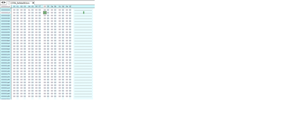

mohammed_aitben
I am talking about AN12283 app notes.
I download package demo from from community : https://community.nxp.com/message/1266918?commentID=1266918#comment-1266918
below my CFPA binary file.
You said that my CFPA looks OK ! but when i write CFPA 0X9DE00 i get always : Flash out of date CFPA PAGE !

mohammed_aitben
Hey TomasVoda
I edited my CFPA file and I moved 0x9DE18 @ to 0x01 value.
But still can't update my CFPA PAGE into device !
Any help !

tomas_voda
Hello Mohammed,
CFPA version is based at address  0x9de04 -> blhost -p COM12 read-memory 0X9DE04 0x4 (keep in mind endianness)
When you want to update CFPA than version of new CFPA has to be higher then previous version.
How do you want to update CFPA? I expect you use blhost -p COM12 write-memory 0X9DE00 new_cfpa.bin
Be sure that in new_cfpa.bin which is 512B file is at address 0x4 incremented version register.
Also keep in mind for proper security setting we have one way changing possibilities for some registers in CFPA.
Ensure the secureFwVersion in new CFPA must be >= existing secureFwVersion
Ensure the nsFwVersion in new CFPA must be >= existing nsFwVersion
Ensure the vendorUsage in new CFPA must be >= existing vendorUsage
Ensure that the imageKeyRevoke must be >= existing imageKeyRevoke
Note the imagekeyRevoke are treated like OTP, the version increasing flow, (0, 1, 3, 7, etc)
Ensure that the rotkhRevoke must be >= existing rotkhRevoke
Note the rotkhRevoke are treated like OTP, the version increasing flow, (0, 1, 3, 7, etc)
