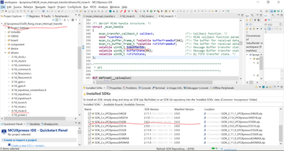

gowthami_budideti
../fatfs/drivers/fsl_mcan.c:1735:47: error: 'mcan_handle_t' {aka 'struct _mcan_handle'} has no member named 'txbufferIdx'
1735 | MCAN_TransferAbortSend(base, handle, handle->txbufferIdx);
When we use the code you've given us we're getting the above error
3,192 Views
xiangjun_rong
i suppose that this is an issue for different  SDK package version. On my SDK ver2.8.2, the
_mcan_handle has the txbufferIdx member.
But my SDK version is a bit old.
XiangJun Rong
