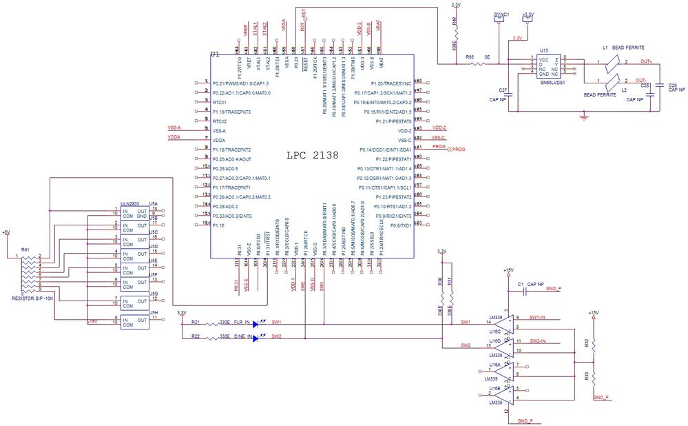

As per reply on mail from NXP,
Hello Sir/Mam,
Its mean that 1K ohm resistor of pull up is enough for LPC2138 MCU?
Before that I was calcualting Pull resistor value as
VCC = 3.3 V, Maximum sink current is 4 mA.
SO I am considering maximum sink current 1 mA.
So Pull Up resistor value  = R = V/I = 3.3/1mA = 3.3 kohm
Is this is right ?
I am interfacing LPC2138 with different ICs.
Problem is that LPC2138 pins gets fail after use 1-2 months.
I am trying to find the root cause of the problem
1. P1.31       -------- OUTPUT ------- TO DRIVE ULN2803 IC
2. P0.23      ---------OUTPUT ------ TO DRIVE SN65LVDS IC
3. P1.26,P0.3 ------INPUT ------ SENSING OUTPUT OF LM339 IC
Point is that either LPC2138 is not capable to drive these IC . SO gets fail after use of some days or there are any other mistake.
I am attaching circuit. Please check & suggest.
Thanks & Regards
7,325 Views
jitender_kumar

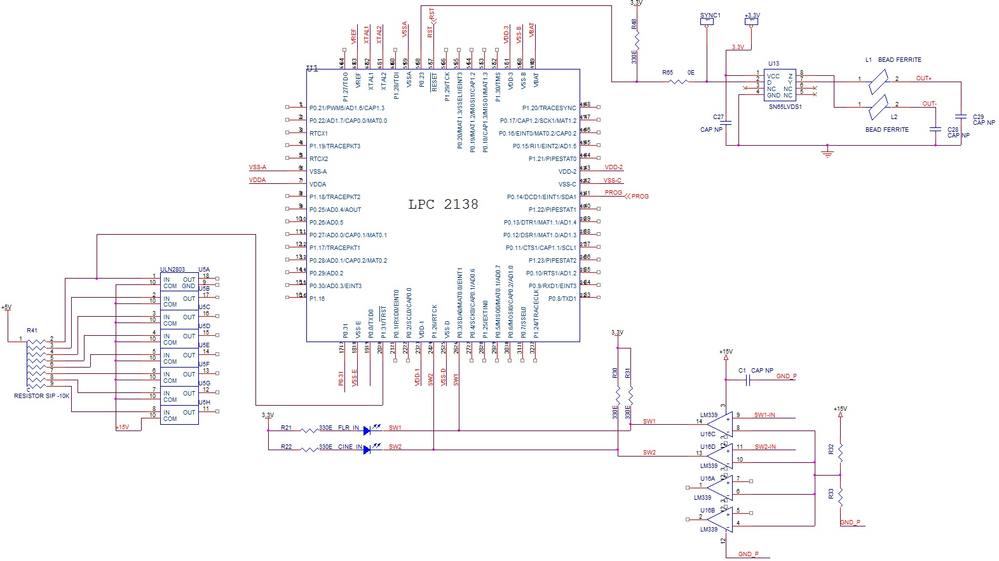

I am using attached circuit in one project.
Problem is:
1.I am using P0.23 (Output Pin) to drive SN65LVDS Ic, But this pin fails after after time. I am not finding the exact root cause of the problem?
2.P1.31 (Output Pin) to drive ULN2003, But this pin fails after after time. I am not finding the exact root cause of the problem?
3.P0.3 & P1.26 as (input). But again same failure problem.
I think it may be due to improper pull up resistor value. Please suggest.
7,325 Views
bernhardfink
330Ohm as pull-up on an output generates a static current of 10mA in case the output is driven to LOW. If there is no special reason for such a high load, then make it a 10kOhm.
The connection on P1.31 could be a problem, because you pull the 3.3V output up to a 5V domain. I have to think about any side effects.
For P0.3 and P1.26 it doesn't matter, you could connect it directly to 3.3V or to GND, the input doesn't care. 330Ohm here most likely doesn't make sense, but it does not affect in any way the physical structure of the input.
What means "fail after time"? How does the fail look like and what's the time period?
Can you measure voltages above 5V on these pins during normal operation?
Bernhard.

Hello Sir
According to your suggestion, Connection is ok ?
1. Fail Time period may be 1 month  if we use regularly it in 5-6 hours.
 These pins goes to permanently low state (0 v). As i checked with CRO.
7,325 Views
jitender_kumar
Waiting for Reply. I have shared my circuit with you. Please suggest what  I am doing wrong in this circuit.
As per your remarks:
(1) 330Ohm as pull-up on an output generates a static current of 10mA in case the output is driven to LOW.
Remarks:
But LPC2138 has 4 mA Sink current. So may be this 330 ohm value is wrong here?
We have to use the resistance which can limit current upto 4 mA.
 So if we use 3.3K ohm resistor. That this static current will be 1 mA. This may be ok for safety of pin?
Because with 10 k ohm resistance, this current will be limit to 33 uA.
(2) The connection on P1.31 could be a problem, because you pull the 3.3V output up to a 5V domain. I have to think about any side effects.
Remarks: 5V pull up may be reason for fail of this pin. Fail means permanently 0V.  So we have to drive the ULN2003 Current driver IC with this pin. SO we can directly connect this pin with ULN2003 without pull up.
(3) P0.3 & P1.26 (input) has same case. May be this is due to 10 mA static current. As it is Pull up with 330 ohm resistor.  I have not observed any 5V on these pins. But these pins goes to permanently low voltage stage and doesn't operate. So if we pull up with 3.3 K ohm then static current will be 1 mA. safe limit for mCU.
Please suggest.
