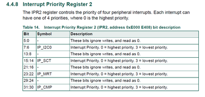

so I will try to have the SCT timer creating a pwm and triggering an interrupt at each rising and falling edges of the pwm. Does the SCT timer have an interrput priority higher than the MRT timer? can I modify the priority order?
1,762 Views
xiangjun_rong
I suggest you generate PWM with  edge-alignment mode, so the rising edge and falling edge are controlled by different events for SCTimer module. Each event can fire an interrupt.
As you know that the SCTimer is interrupt source, the MRT is another interrupt source, each interrupt source has an independent 8 bits interrupt priority register, so you can program each interrupt source priority by programming the 8 bits interrupt priority register.
You can program IPR2 to configure the SCT and MRT interrupt priority.
I copy from UM10800.pdf
Hope it can help you

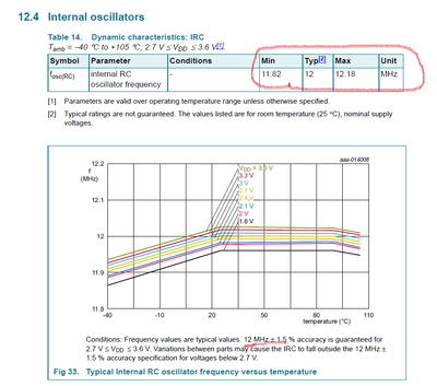

How can I evaluate the jitter of the SCT timer?  let's say that I would like to generate a 100Hz pwm with 30Mhz system clock. I set the ctrl and matchrel registers to get the 100Hz period
SCT0->CTRL|=(199<<5); // to get a 150kHz clock to SCT
SCT0->MATCHREL[0]=1500; // to get about 100Hz period
Which is the expected accurcay on the 100Hz frequency using the Internal IRC oscillator?
It seems that increasing the values of MATCHREL register increase the jitter of the PWM
1,744 Views
xiangjun_rong
The PWM signal clock frequency accuracy is solely dependent on the IRC clock frequency accuracy, which is used to drive SCT module via PLL or not.
This is IRC clock frequency accuracy 12MHz+/-0.15% for LPC82x.
If the output PWM is 100Hz, the jitter will be 100Hz*(+/-1.5%), in other words, ranging from 98.5Hz to 101.5Hz.
