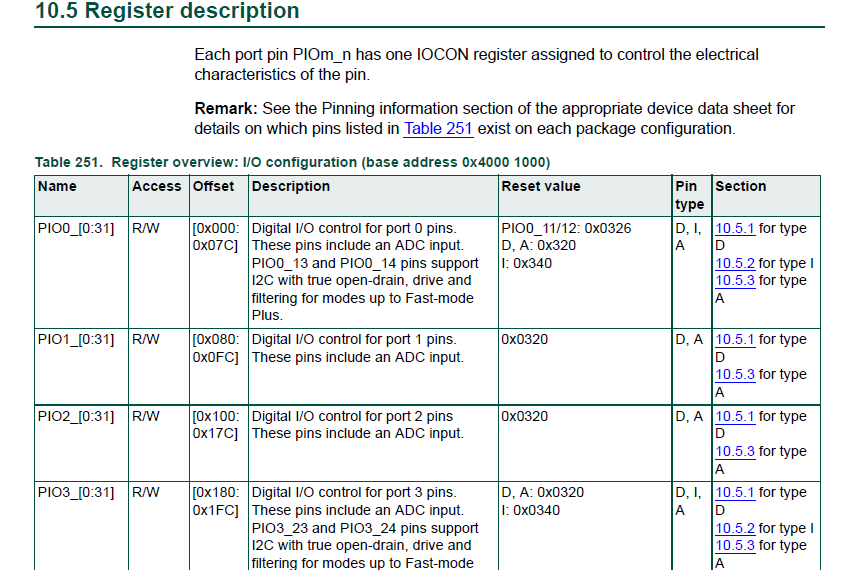

Pls refer to the UM10912.pdf and check the Chapter 10: LPC546xx I/O pin configuration (IOCON), which describes the pin assignment.
Hope it can help you
XiangJun Rong

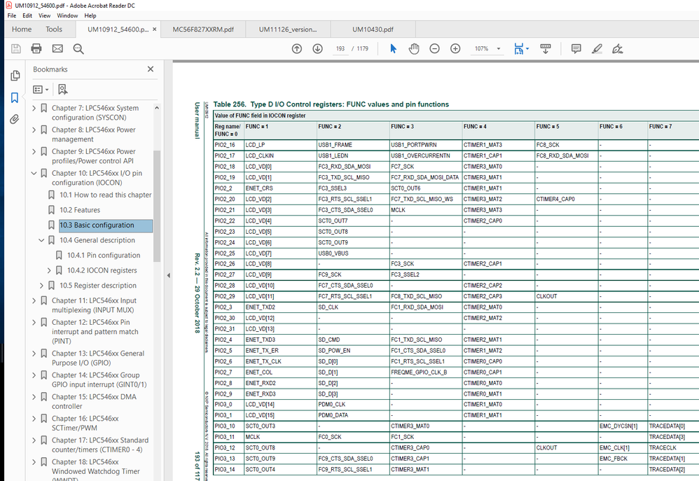

yasokada
Dear XiangJun
Thank you for your reply.
I have read that part. But, it's not clear how the [LCD_VD[9] (PIO2_27) works as a reset.
The connecting diagram or table between the LPCXPresso54628 and the Rocktech LCD module may help,
but I didn't find it on the documents, not on the Datasheet for Rocktech LCD module REV1.0 also.
The sentence on the SDK example looks like a magic. I do not want to use it without knowing the detail as an engineer.

Pls refer to the following section, during and after Reset, the IOCON register  for all PIO2 port pins is 0x0320, which means that the PIO2 pins are in GPIO mode, the default value of GPIO port direction register is 0, so the PIO2 pins are in GPIO and input mode during/after Reset.
Xiangjun Rong

I am sorry, I misunderstood your original question previously, as you know that the PIO2_27 pin is connected to the Reset pin of Cap Touch RK043FN02H-CT LCD display.
As you know that PIO2_27 can be configured as GPIO pin, after reset, the application code is run, in the application code, if you need to display something and touch the screen, you can configure PIO2_27 pin  as GPIO and output mode with the line:
GPIO_PinInit(GPIO, 2, 27, &pin_config);
then you can clear the PIO2_27 to reset the Cap Touch RK043FN02H-CT LCD display with the line:
GPIO_PinWrite(GPIO, 2, 27, 0);
//because of an external pull-down resistor and the pin is in input mode during/after chip Reset, so the PIO2_27 will //be in LOW logic, so the line maybe removed.
//after a programmable delay like
delay();
//then set the PIO2_27 pin with the line:
GPIO_PinWrite(GPIO, 2, 27, 1);
//It is okay.
During and after processor Reset, the PIO2_27 is in input mode, because of a pull-down resistor, the pin is LOW. after the above application code is run, the PIO2_27 will finish LOW logic, Delay, High logic, the Cap Touch RK043FN02H-CT LCD display. will be Reset.
