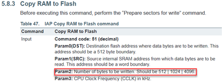

We are using LPC1833 in our project. In which we are flashing an image of 87 kB size.
But not able to use more than 8 kB of Flash Buffer size to flash the image.
How we can use more than 8 kB of buffer for the same?

Hello
Hope you are well.
Unfortunately, the supported values of bytes to be written are the ones listed in the reference manual.
I apologize for the inconvenience this may cause you, if you have more questions do not hesitate to ask me.
