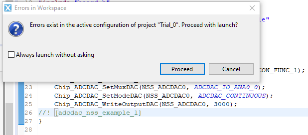

I am using NHS3152ADK, LPC-link2 and LPCXpresso IDE.
I am trying to run example adcdac_nss_example_1.

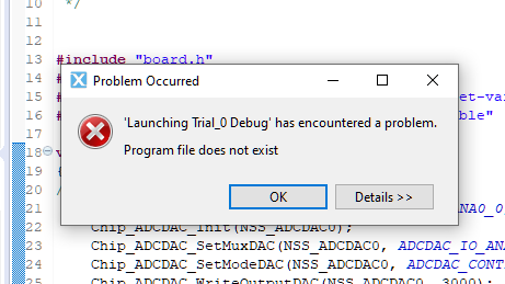

When i debug, i get the following message:
After i click proceed:
How do i fix this?

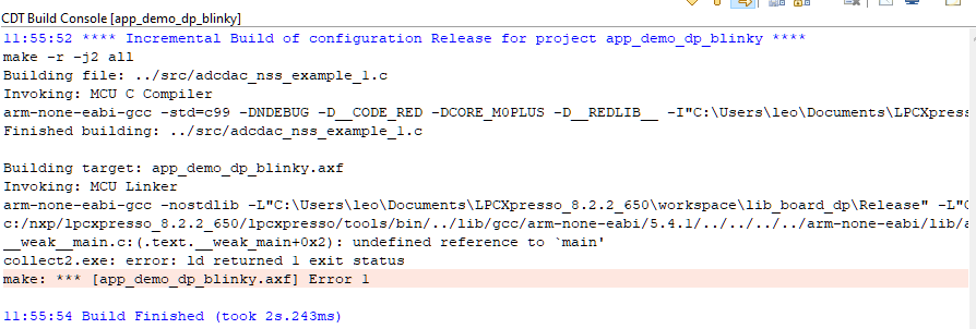

The problems screenshot you posted shows a linker error: it cannot find an implementation of the main function.
The example_snippets folder does not contain complete projects, it only contains code snippets surrounded with some C sugar to enable compilation checks and test runs by the development team (include, pragma's, function prototype). The code snippet shows code that is functional and as minimal as possible, to get you started faster. Every code snippet is included in the firmware documentation at <SDK>/docs/firmware.html.
The example you refer to is also listed there: navigate to Documentation of the low-level HW block drivers > adcdac: Analog-to-Digital / Digital-to-Analog converter driver > Example 1 - Continuous Digital-to-Analog conversion with polling.
To use the code snippet, just copy what is listed in that documentation to your own project - which should already be in good shape (have a main, compiling and linking, etc.) - inside whatever function.

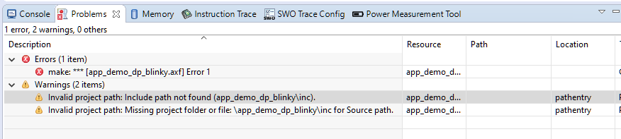

It seems your project does not compile or link. Did you paste the full contents? I don't see main, for example. Can you have a look at the errors - if you inadvertently closed them, navigate to Window > Show view > Other... > General > Problems and/or Console.
The examples are used in the firmware documentation <SDK>/tools/firmware.html. To use them in your project, copy and paste the code in e.g. the blinky demo project, after the call to Board_Init.

I have placed, adcdac_nss_example_1 in blinky demo folder, and when i debug i get these problems:: pastedImage_3.png
