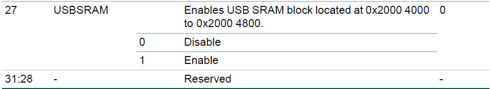

Magnetron
1. Yes, I tried use RAM1 instead RAM2. The same result, not working.
2. What is USBSRAM?
3,344 Views
jeremyzhou
Hi Denys Yurchenko ,
Thanks for your reply.
I was wondering if you can introduce the demo code in details, and it will help me to figure out the root cause of issue.
Regrading to the USBSRAM bit, it is used to enable or disable the USB SRAM block which has been indicated in the Table 19 in reference manual.
TIC
