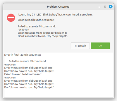

When I try to debug my code, it builds without failure but MCUXpresso cannot connect to the debugger board:

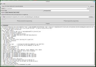

However, if I close MCUXpresso and try to use LinkFlash 25.6.131 - it is automatically installed together with MCUXpresso - then I see, this SW connected to the probe with no issue:

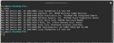

Here's the output of LSUSB:

Found a solution - after a few days of try-and-error:
Left side, in the project explorer window, right-click on the project name.
In the pop-up  menu, select Debug As -> 2 MCUXpresso IDE Link Server (inc. CMSIS-DAP) probes.
And, voila!  It works.
