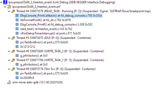

Hello
I have both a question and a possible bug to report related to what is needed to use the FPU on the LPC55S69 processor with FreeRTOS. For the purpose of this question/bug-report, I have tried to simplify my issue into a simple, reproducible example.
I'm working with:
  • LPC55S69-EVK (revision A - 100Mhz clock),
  • MCUXpresso 11.4.0, and
  • SDK_2.x_LPC55S69 version 2.10.0
My issue appears with a small modification to the stock "freertos_event" example (within MCUXpresso, File->New->Import SDK Examples, filter for "freertos_event" example, select it, click Next and Finish).
This example creates 2 write tasks that use an event-group to notify 1 read task. I then modify the example by adding a very simple floating point operation in the while loops of each of these 3 tasks:
if(xTaskGetTickCount() != 3.14f){
  PRINTF("write_task_1 uses float");
Whenever I use my Segger JLink Plus as the debugger (in all-stop mode, connected to the 10pin SWD header on the development board), the task-aware debug stack trace shows that each of the blocked tasks has "g_pfnVectors at 0x0" as its trace (see picture below).
However, when I use the development board's built-in debugger, the "LPC-LINK2 CMSIS-DAP V5.182", with the exact same code, I get the following much-more reasonable stack trace (see picture below):
This inconsistent behavior between the two debuggers makes me wonder whether I am using the FPU + FreeRTOS correctly or if I'm introducing some latent memory corruption.
This leads me to my first question:
I know that in a recent SDK release the "FreeRTOSConfig.h" file was updated so #define  configENABLE_FPU is now 1 (when I think it was 0 in SDK 2.8). But, do I also need to:
  • call "portTASK_USES_FLOATING_POINT();" at the start of each task?
  • or "#define configUSE_TASK_FPU_SUPPORT 1" or "#define configUSE_TASK_FPU_SUPPORT 2" in FreeRTOSConfig.h?
My second question (possible bug report) is:
Behaviorally, this example code seems to run fine (even when I make the floating point operations more sophisticated), so I would assume the LPC-LINK2 debugger is showing me the accurate stack trace. Is the JLink's stack trace wrong? And, is there something I can do to make the JLink trace look more like the LPC-LINK2's trace? - The reason I care is: while this example has been boiled down to run on the development kit, I do have a close-to-production board which I can only debug with a JLink.
And, for completeness, this is the entire "freertos_event.c" file used to create the above images. No other files were modified from the stock-example.
