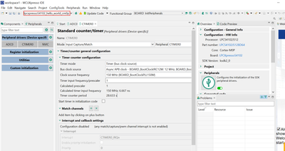

Do you use standalone MCUXpresso configure tool or integrated in MCUXpresso IDE?
I test with MCUXpresso IDE V11.6, it can work well:

I am curious Alice is the example you are showing a dual core project?
4,333 Views
Yes, this is a dual core project under SDK demo:
