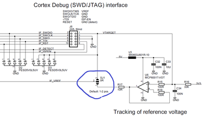

Hi Sir,
Would you share us how to rework MCU link to support LPC8xx with power rail 1.8V?
We know that the MCU link design is for 3.3V.
Is it possible to support 1.8V by HW rework? Thanks.

As long as your target board provides the 1.8V voltage sensing through pin 1 of the SWD connector, you don't need to change the MCU-Link or SJ1 at all: everything should work as VTARGET is used as voltage level to IF_VREF:
To my understanding, changing SJ1 is not advised and only needed, if you board does not provide VTARGET on pin 1 of the SWD connector.
I hope this helps,
Erich

We reverted the driver one version and the mcu-link was discovered and able to connect/debug. We then moved SJ1 to pins 2 and 3, and removed R16, and R15 but we still see 2.5V on our 1.8V rail. This is pin 1 on the programming header. We only see 2.5V when we run the debugger. If we halt debugging the rail returns to 1.8V.
Again, we only see 2.5V when we are actively debugging. 2.5V is seen both on the the MCU-link at sj1 -pins 2/3 and on our board.

Moving SJ1 to position 2-3 and removing R16 should be enough to make MCU-Link (base model) work with a 1.8V target. If R16 isn't removed then there is a 33K resistor to MCU-Link's 3.3V supply, and that might cause issues in some systems. SJ1 is used to set level shifters to the right target-side voltage for the SWD port.
The status LED should be slowly fading in and out when the software is running correctly. If this is happening but the board will not enumerate then you might have damaged the board, but it would be helpful if you could state the MCU-Link firmware and MCUXpresso IDE (or other tool) versions you are using.
Just in case, please also confirm the target is being powered by your board (since the base model MCU-Link cannot power targets, only MCU-Link Pro can).

xiangjun_rong
Hi, Stephen,
It is possible to support 1.8V power rail.
As you know that the LPC8xx supports 1.8V power rail, on your target, your LPC8xx processor is powered by 1.8V power rail, of course, the SWD signals are also 1.8V power rail.
As the following figure of part of SWD connector on the MCU link board, in default pin 1&2 are populated in default for SJ1, you have to remove the resistor on the pin1&2 of SJ1, and populate a 0 ohm resistor on the pin2&3 of SJ1.  On the 10 pin  connector on your target board of LPC8xx, you have to connect 1.8V power supply to pin1 of connector so that the buffer circuit on the MCU link board can get 1.8V power from your target board.
In conclusion, pls connect 1.8V power supply to pin1 of the 10 pin connector on your LPC8xx target board. Pls remove the resistor on pin1&2 for SJ1 on the MCU LINK board, and connector a 0 ohm resistor on pin2&3 for SJ1.
Note that the SJ1 is closed to the LED1 position on the top right of the MCU LINK board, it is small, difficult to remove or populate any resistor.
