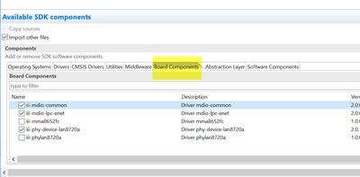

New Project, added SDK and the LwIP Middleware.  Project will not compile because of missing references:
../lwip/port/enet_ethernetif.c:76:5: error: unknown type name 'phy_config_t'; did you mean 'pll_config_t'?
76 | phy_config_t phyConfig;
Am I missing something to get this to build?

ZhangJennie
The error means you didn't add phy files to your project, please add them from SDK component. for example:
