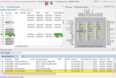

I Working on LPC54018-EVK . i should config spi on this Board. The first pulse of clock
Width should be high(On+Off =width of first pulse).And The Spi Ssel0 How can be enable.

In order to enable ssel0, we need:
1. config ssel0 pin in pin config tool. for example (this screenshot is from LPC55s69, but same for your device)
after generate code, new pin_mux.c will  include ssel0 pin initialization code

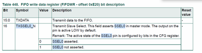

step 2. set TXSSEL0_N FIFO write data register to select ssel0 spi device.
Hope this will help you
