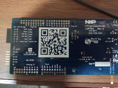

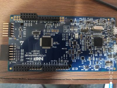

I am using the LPCXpresso54102 board in my system as a USB to UART bridge. I am running into an issue where Bridge is unable to communicate with the device. I have debugged the issue and found that voltage on I2C_SCL and I2C_SDA lines is lower than expected(2.5V).
I have traced the issue to the LPCXpresso54102 board. I am attaching images of the board below.
I have taken the below steps to resolve the issue but I can not get 3.3V on I2C_SCL and I2C_SDA line
1. Connected 2.2K pull-up on R19 and R20.
2. Connected JP7.2 and JP7.3 for 3.3V as suggested in SCH
Let me know if more Jumper needs to be connected for properly using LPCXpresso54102 board as USB to I2C bridge.

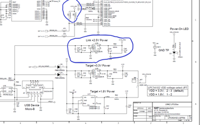

Maybe I got the cause, pls refer to the following Fig, the LDO outputs 2.5V instead of 3.3V, but it is labeled as +3.3VLINK, it is wrong, that is why you get 2.5V logic voltage.
Pls remove the JS1 and JS2, populate the R19 and R20, close pin2&3 of JP7, I suppose that you will get 3.3V logic for the BRIDGE_SCL/SDA pins.

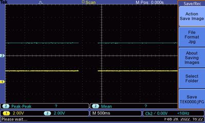

Do you use oscilloscope to test the two signals: SCL and SDA? if it is, pls post the screenshot of the scope so that we can see the high logic voltage of the signal. You can not use the multimeter to test the voltage of the signals.

Please find attached a screenshot of the SCL and SDA line.
Channel 1 is SDA and Channel 2 is SCL we are getting approx 2V. Currently, only LPCXpresso54102 is there we have not connected the I2C line to our unit.
