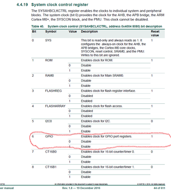

Regarding your PINT0 configuration, I do not see the code to enable module gated clock for IOCON, GPIO and PINT.
SYSCON->SYSAHBCLKCTRL|=(1<<6)|(1<<16)|(1<<19);
The line enable GPIO, IOCON and PINT gated clock, pls add it before you write register of above modules.

xiangjun_rong
Pls refer to section 4.4.19 System clock control register in UM10732.pdf
Hope it is helpful

jDrum
Thanks for the reference.
We have previously used this clock for I2C and UART and possibly for Flash. I plan to look at a general ARM manual to see if I can finally figure out how the LPC clocks work. Very complex.
