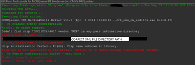

I am attempting to flash a board using the command line.
Chip is an LPC11U24/401
Attempting to flash using LinkServer with the command:
LinkServer.exe flash LPC11U24/401 load "Main.axf"
Gives the error:
INFO: Exact match for LPC11U24/401 found
INFO: Selected device LPC11U24/401:
INFO: Getting available probes
INFO: Selected probe #1 MLXAIXAEG1GMO (MCU-LINK (r0FF) CMSIS-DAP V3.133)
INFO: MCU-Link firmware update CHECK: local firmware [3.140] can be programmed on the selected probe ([MLXAIXAEG1GMO] [MCU-LINK (r0FF) CMSIS-DAP V3.133])
Firmware update CHECK: - the update can be performed using `AUTO` mode
CRITICAL: Critical error
ERRMSG: FileNotFoundError: [Errno 2] No such file or directory: 'C:\\Users\\LM\\AppData\\Local\\Temp\\tmp7_naesyr\\LPC11U24/401.xml'
Since a file cannot exist with a forward slash in it, something seems wrong here with what its looking for (LPC11U24/401.xml).
I am able to flash using redlink, on the command line, with the command:
./crt_emu_cm_redlink.exe --flash-load-exec  "Main.axf" -g --debug 2  --vendor NXP -p LPC11U24_401  --probeserial MLXAIXAEG1GMO -CoreIndex=0 --flash-driver LPC11_12_13_32K_4K.cfx -x "<PATH TO DEVICE XML FILES>"  --flash-hashing
However, when I run the GUI flash tool through MCUXpresso, the redlink command produced is the same as above, but with the LPC11U24_401 replaced with a LPC11U24/401, which again causes it to fail with an error.
My device/chip XML files both exist in the directory its looking in for them, but they are named LPC11U24_401.xml and LPC11U24_401_part.xml because you cant have a forward slash in a file name, which seems to be what the programs are looking for.

Hello, thanks for your comments the report was uploaded, and the engineers will work on this for the next release, however, I have reproduced this issue on LPC11C24 since I only have this board.
As for the solution, I also download the latest version of MCUXpresso IDE and LPCOpen example. I have verified that using MCUXpresso IDE v11.10.0_ear2, the code example can be programmed and run successfully on LPCXpresso11C24/CD rev PA1 board.
