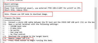

I am working on an LPCXpresso 55S36 and using SDKs "lpcxpresso55s36_i3c_polling_b2b_transfer_master" and "lpcxpresso55s36_i3c_master_read_sensor_icm42688p" and I haven't been able to make either of them work properly.
It seems like the SCL line (J9 pin 20) is working properly but I see a really long rise time on the SDA line (J9 pin 18). I have attached an oscilloscope capture for both SDKs
Could I have a setup issue, my board be damaged, or have you seen this type of issue before? Does the SDA line require a pullup? Thanks

Hello @amonreal
Please refer to readme.txt to configure your board:
Alice

amonreal
Hi @Alice_Yang
Thanks for your reply. I did do all those steps when I got these captures as you can see from the third picture attached on my original post. Do you have any more pointers?

Hello @amonreal
If run the demo "lpcxpresso55s36_i3c_polling_b2b_transfer_master", need connect with another board as slave. About the demo "lpcxpresso55s36_i3c_master_read_sensor_icm42688p", I tested it before, it can well, no issue, recommend you check carefully again refer to readme.txt.
