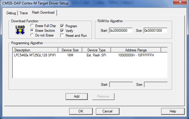

xiangjun_rong
Hi, Viet,
Regarding your question that the PC can not recognize the OM13098, I suppose that you close the JP5(DFU LINK) on the board, pls open the JP5 jumper.
Secondly, I suppose that the Keil can not find out the flash algorithms which leads to the error, pls refer to the following figure. If the programing Algorithms is blank, pls click the  Add software button to add the flash algorithms.

vn2000
Hi Xiangjun,
I added the flash algorithms as you said. But somehow the address shown is a little different from your example (10000000H instead of 00000000H).
With the address 10000000H, I see this error:
Load "debug\\hello_world.out"
No Algorithm found for: 00000000H - 00002D13H
Erase skipped!
Error: Flash Download failed - "Cortex-M4"
When I changed the address to 00000000H, I see this error:
Insufficient RAM for Flash Algorithms !
Erase Failed!

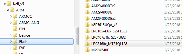

I also noticed the Device Type in my environment says it Ext Flash SPI. In your dialog I see 'On-chip Flash'. The only logical choice for adding algorithm is LPC5460x.
Also, when I looked at the Keil_v5/ARM/Flash directory, here is what I see:
Here I only have one choice for LPC5460x_MT25QL128. So there is no LPC5460x_IAP as you have.
What do you think I should correct?
