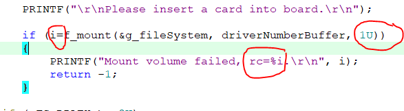

When running the sample from the SDK 2.2:
we get error for a number of different SD cards (we assume it is the card type that is not supported). Is there any plans for changing the drivers? The plan here was to use the fatfs and the fsl drivers for it. Seems it is currently not possible (unless customers are using the SD cards supported). We only needs very small amount of data stored, so 1GB cards would be more than sufficient. We saw the error on our own hardware originally (LPC54606) and moved to the LPCXpresso54608 board to verify.
Only change to the original sample is "USE_MKFS" is set to 0 and:

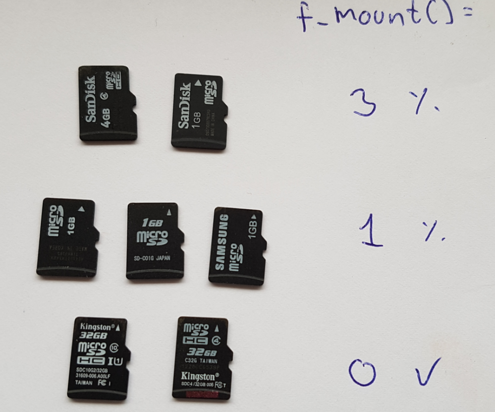

The cards tested and their returncode from f_mount():
(Please note that the 4GB card labelled "SanDisk" with SDHC also does not work)

JohnU
See also sdmmc SD_Write()/SD_Read() failed with ATP card
"The issue concerns sdmmc library bug (I finally solved) in SD_Init() in the file sdmmc/src/fsl_sd.c:
SD_SelectBusTiming() calls SD_SwitchFunction() which sets block size to 64bytes (512bits).
Therefore SD_SetBlockSize(card, FSL_SDMMC_DEFAULT_BLOCK_SIZE) should be called again before SD_Init() exits."
best regards
J.
6,311 Views
carstengroen
Senior Contributor II
Thanks a lot John,
this seems to fix the problem for our old cards!
I just, as you recommended, added  SD_SetBlockSize(card, FSL_SDMMC_DEFAULT_BLOCK_SIZE); just before the SD_init() function exits. :smileyhappy:
