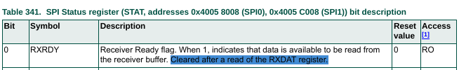

From UM11029:
When NOT STEPPING through the code it works.
So why is RXRDY flag automatically reset shortly after setting without reading RXDAT register?

EDIT II: After a relaxing weekend I think it's the debugger. In the next step the debugger reads the registers, of course RXDAT as well if watched. And this is the required action to reset the RXRDY flag...
