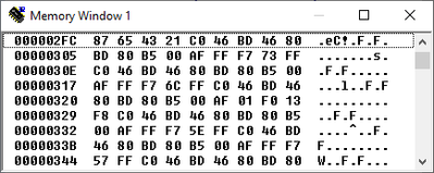

kwagner
Hi Alex,
Thanks for your reply! For some reason, I'm still running into some issues. After setting the bytes to '87654321' (CRP2) and power cycling the microcontroller, I'm still able to debug through MCUXpresso and I'm still able to read the full memory through PROGACMP.
Looking at the memory, I can see that it is set to '87654321'. Does this look correct to you?
Anything else that I could be missing?
Thanks again for your help!

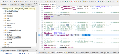

Hi, @kwagner
Did you manually change the value of 0x000002FC? It seems to be okay. You can try it by setting CRP in the following ways:
Set it in starup_lpc824.c as follows:
Then download to the development board.
Best regards, Alex

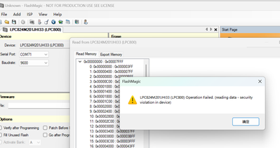

I used the LPC824 development board to set CRP1 and CRP2. After the setting, I could not burn programs and debug through the IDE, nor could I read any values, and I could erase the whole film through ISP mode. As follows:

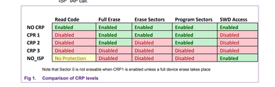

The following operations can be performed at different levels:
Best regards, Alex
