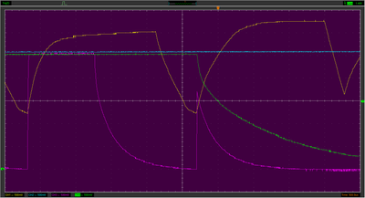

Traces
The below trace shows a test run from power-on. The fault can be seen where PIO0_12 (ISP) becomes a sink. The device traps into ISP mode and stops on the next reset.
Figure 1: CH1 = PIO0_5 (RESET), CH2 = PIO0_2 (TMS), CH3 = PIO0_3 (TCK), CH4 = PIO0_12 (ISP)

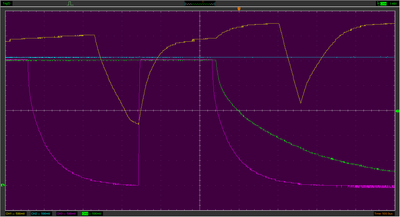

The next trace shows the same failure mode with a narrower time base. The accelerated RESET rise after the fault is normal and caused by a capacitive coupling to PIO0_22 which has started sourcing after the fault.
Figure 2: 500µs time-base

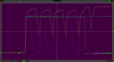

The next trace shows PIO0_12 (ISP) going high impedance instead. The resulting pin resulting configuration is not consistent.
Figure 3: ISP high impedance

Analysis
The MCU is assumed to have entered JTAG boundary-scan mode since:
  1. The inaccessible pins correspond to the boundary scan cells. The accessible pins correspond to JTAG control signals and REST.
  2. The boundary scan exit procedure of sinking PIO0_4 (TRST) during and asserting RESET restores normal mode.
The TCK pulled-up is restored on reset and results in a rising clock edge after the falling edge of RESET. This is assumed to sequence the JTAG TAP.
The effect of the falling clock edge after releasing RESET is less clear. A guess is that a floating input without hysteresis induces oscillation which results in a timing violation or metastability and places the TAP into an unintended state.
Clearly the intent is that boundary scan should normally only be operated during RESET. This is variously described in table 314 and the top of section 28.5.3 of UM11065 rev 1.3.
The sequence for exiting boundary scan includes releasing TRST and implies that that it may be possible to remain in boundary scan after RESET:
“Once the boundary scan operations are completed, assert the TRST pin to enable the SWD debug mode and release the RESET pin” (section 28.5.3 of UM11065, rev 1.3).
This section includes the surprising statement that the TAP operates outside of RESET and disregards TMS:
“POR, BOD reset, or a LOW on the TRST pin puts the test TAP controller in the Test-Logic Reset state. The first TCK clock while RESET = HIGH places the test TAP in Run-Test Idle mode” (section 28.5.3 of UM11065, rev 1.3).

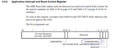

Hi,Johan,
Regarding your following code, I do not think that the following code can Reset the LPC804.
If you want to Reset the LPC804, you have to connect the LPC0_5/Reset pin to source which can set/clear the pin.
If you want to reset the LPC804 itself with software, you can write the SCB->AIRCR.
SCB->AIRCR|=1<<2;
Hope it can help you
XiangJun Rong

jforslof
Hello XiangJun,
Thank you for your interest.
As near as I have been able to determine disabling the internal pull-up on the RESET pin without an external pull-up resistor present does appear to work in my tests. As can be seen in the oscilloscope traces the signal drops and recovers immediately on hitting the low level threshold as would be expected, and afterwards code execution again reaches the start of the vector with EXTRST asserted.
Using a software reset via AIRCR instead fails to reproduce the problem. I suspect that this is related to JTAG boundary scan operating independently of normal peripherals during the reset state and based on the physical signal. Incidentally. Incidentally, I believe that a 0x05FA << 16 vector key is also needed for the SCB to accept a software reset request.
To be clear we are not relying on this method of reset in our actual application. This is used purely to demonstrate the problem. The original test case used an external reset pulse generator but doing so internally in the code simplifies the setup by avoiding the need for external test equipment.
