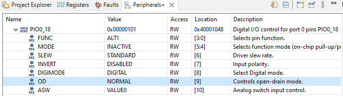

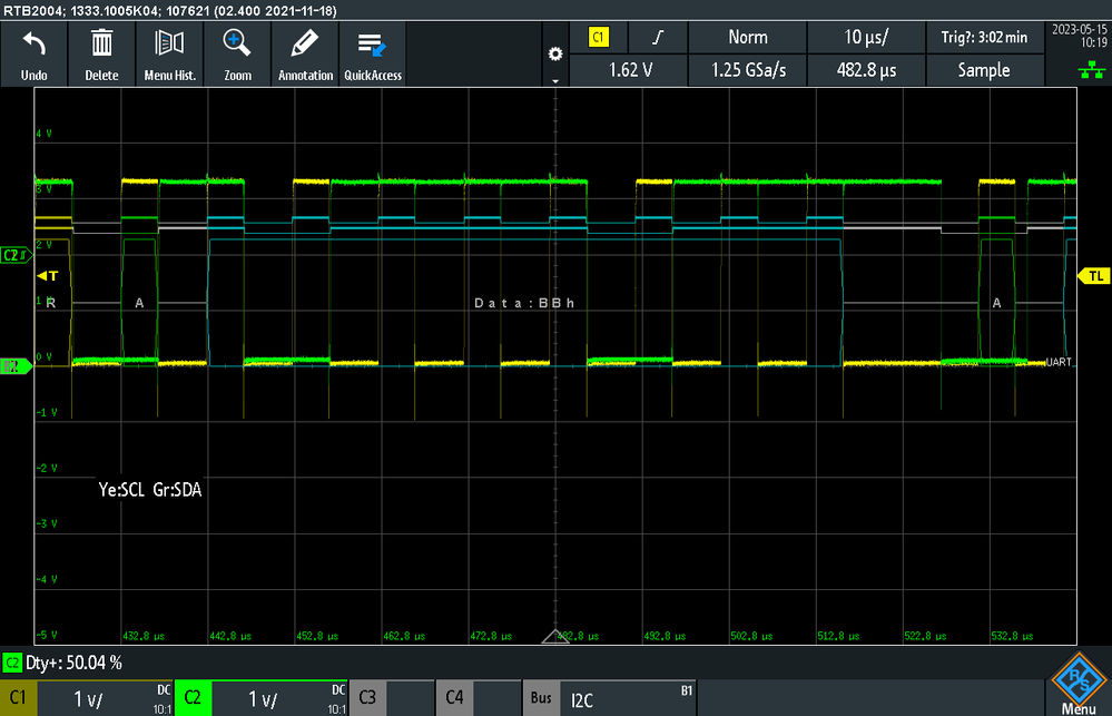

you are absolutely correct. I know that I2C bus relies on participants to use open drain output drivers.Thus I'm still puzzled why the I2C bus worked at all although I had "open drain" disabled on the I2C pins.  The I2C communication is fine, see my scope shots. Thus I had no need to actively enable open drain on these pins.
I just checked using Peripherals+ view in MCUXpresso IDE: no matter how the open drain bit is configured, I2C works with  PIO0_18 (SDA), scope shows valid I2C protocol and slave is able to pull down SDA properly (to specified minimum low level). 🤷‍

danielholala
Senior Contributor II
Thanks, XiangJun, I will configure these "standard" pins as "open drain" now when used for I2C bus. This will be more standard compliant.
NB:

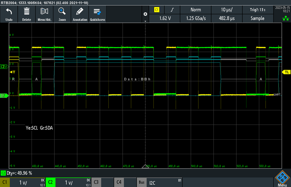

In my design only a single I2C EEPROM is connected to the I2C bus. Strangely enough, the I2C bus worked even without this configuration.
I wonder how the EEPROM managed to send ACKs  or data (by pulling down SDA) when the LPC never released SDA (as it was not configured as open drain). In fact, I see no difference regarding SDA signal on the scope whether configured as open drain or not through Pins Tool.
SDA pin #38 (PIO8_18) NOT configured as open drain:
SDA pin #38 configured as ppen drain (OD = 1):

Anyway, both the SCL and SDA signal must be in open drain configuration, maybe after you configure the pins as I2C in IOCON register, the pins will be in open drain automatically.
Xiangjun Rong
3,600 次查看
danielholala
Dear Xiangjun,
Thanks. I configured pins, clocks and i2c interface using Peripherals Tool. If anything sets the pins to be open drain, it wasn't me.
I'm beginning to suspect that it is sufficient to configure the pin function as SDA using IOCON and that the OD bit has no relevance while a I2C function is enabled (see my other posting).
