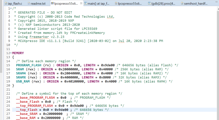

Could you give some recommendation for usage of last 32KB flash block 98000-9FFFF of memory.
Test show that is not possible to execute code from it and write/erase some part of it.
Looks like 32KB chunk a real flash memory erasable unit and 512 sectors is just part of it.
FFR area part of it and as usually written via ISP commands by Boot-Rom.
Can I erase/write remain this 32KB block ( 98000- 9DE00)by my SW ( IAP) without any probability to loze FFR context in any scenario ?
Or better do not touch it at all for avoid any problems ?
Does it possible to lock this block somehow ( at secure side start up) that write/erase operations are not possible ?
E.g read only protection like ?
Eugene

I made a test based on 1B part. No problem read/write/erase 98000- 9DE00
