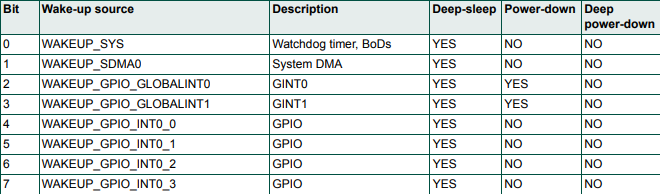

I need to have ISR by multiple GPIO lines in ACTIVE, SLEEP and POWER DOWN modes.
I would like to detect both edges and try to utilize both GINTx and include pin twice and configure GINT0 for detect rising edge and GINT1 for falling edge ( or vise versa).
If only one pin added to both GINTx, both edges are detected. If more than 1, it start to detect falling edge only.
Weird. May be it depends from some configuration what should be used when power management API is called ?
I have checked all possible combinations and haven't find working combination how-to detect both edges for set of pins from both GPIO ports.
Is any limitations exists ? There are not visible in UM.
I have attached exact modified gint example.

There are is not equal. GINTx can include multiple pins and they able to wakeup MCU from POWER DOWN low power mode.
I have 17 pins what should be able to do wakeup.
According spec, every GINTx can have up to 32 pins and do wakeup due falling or rising edges.
Can you expand gint example when all 3 buttons , due any edge can wakeup MCU from power down mode ?

As you mention, the PINT module only has  8 pins to wake up but unfortunately the GINT only can be configured as falling edge or rising edge, not both due to you can only select one polarity. The PINT has 8 ways to wake up the MCU but only in deep-sleep so if you will go to power-down is not an option. What you could do is to connect to two pins the same button and check different polarities but this will waste some pins.
But do you need that this pins to wake up with both edges? If you explain more about your project maybe I could suggest a solution for it.

 Hi Eugene,
Please check my answers bellow:
1. GINT0 can be programmed to detect rising edge. GINT1 - falling edge
Both ports can be configured for falling or rising but not both.
2. Any set of GPIO pins e.g from port0 and port1 can be included to any GPIOx. For example 5 pins from port0 and 5 pins from port 1 can be included to GINT0.
For example, if you want to use the PIO0_6 you will need to enable the bit 6 in the GINT0, each bit correspond to a pin.
3. The same GPIO pins can be included to GINT1 detect other edge. So it is not a limitation when the same pin included to both GINTx. e,g twice.
This conection need to be done physically, so for example if you want to wake up with both edges you will need to connect to a pin in the Port 0 and the Port 1, and one enable with the rising edge and other with the falling one.
I found something strange with the documentation, with my test using the board I found the following behavior.
COMB : 1 | POL : 1 - Each pin trigger the interruption
COMB : 0 | POL : 0 - Each pin trigger the interruption
COMB : 0 | POL : 1 - Need to match all the pins to trigger the interruption
COMB : 1 | POL : 0 - Need to match all the pins to trigger the interruption
I already report this and I'll let you know when I receive some feedback.

Alexis_A
Hi Eugene,
As the reference manual mention in the Table 303. Parameter wakeup_interrupts, the GINT can be used to wake up from Power-Down but the PINT that will correspond to the WAKEUP_GPIO_INT0_x can't be used:
That's why I mention to use two physical pins if you want to wake up from Power-Down using both edges.
Alexis Andalon
