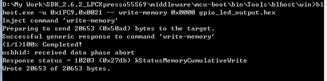

hi  我在用NXP的LPC55S69的时候需要通过USB下载,但是在demo板上发现下载完了,没什么反应,应该是没有成功,工程是通过keil编译出来的gpio例程

Please use *.bin file with write-memory command.
If you want to use *.hex file, then use flash-image command.

Download via USB ISP, use blhost tool, but failed
